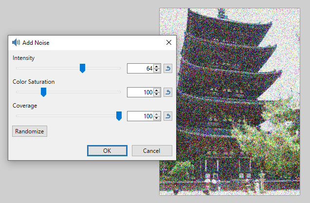

Add Noise
This adds random noise to the active layer or selection.
The effect must be run over areas containing color to produce noise. Running the effect over transparent areas produces no noise in that region.
Example - Effects > Noise > Add Noise

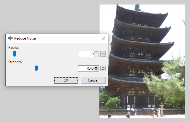

Reduce Noise
This effect is used to reduce digital noise in photographs. This noise generally occurs when digital cameras cannot correctly capture fine details or are produced by the electronics in the camera itself.
Example - Effects > Noise > Reduce Noise
In this example, there is little ambient noise. The difference can be seen in the woodwork detail which looks cleaner after the effect has been run.
