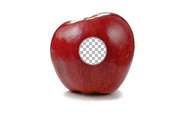

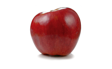

Original Image
Example 2
After using the Eraser Tool in the middle of the image. Note the gray and white checkerboard pattern (denoting transparency).

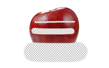

Eraser Tool showing three brush widths.
At the top the Brush size is set to five pixels wide.  In the middle the Brush size is 20 pixels.  At the bottom the Brush size is 65 pixels.

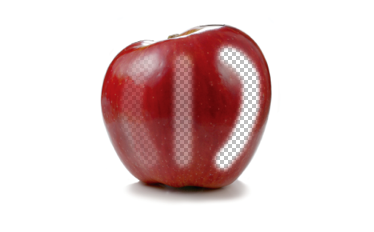

Eraser Tool showing three hardness settings.
At the top the Hardness is set to 10%. Note the soft edge.
In the middle the Hardness is to 50%.
At the bottom the Hardness is 100%.
