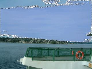

Magic Wand ToolTolerance: 25%. The selection captures most of the sky, but not all. The tolerance is too low.

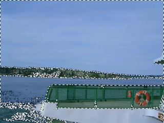

Magic Wand ToolTolerance: 50%. The selection captures all of the sky, but also some of the water and other elements in the photo.
The tolerance is too high.

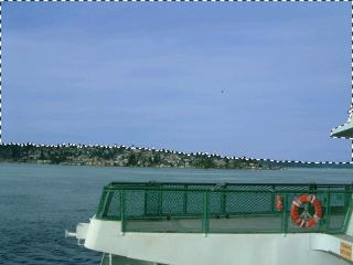

Magic Wand ToolTolerance: 31%. The selection properly captures the area of interest (the sky), no more, no less.

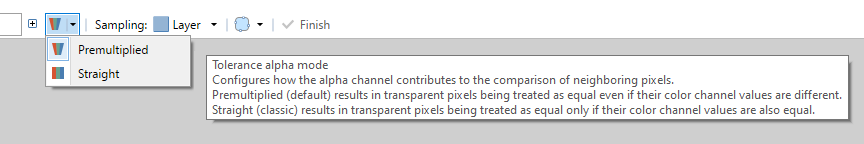

Tolerance Alpha Mode
This toggle button changes the algorithm which determines how the alpha channel contributes to the comparison of neighboring pixels. The states are Premultiplied (default) and Straight.
Premultiplied results in transparent pixels being treated as equal even if the color channels are different.
Straight results in transparent pixels being treated as equal only if the color channel values are also equal.
The Tolerance Alpha Mode toggle button is common to the Magic Wand, Paint Bucket, and Recolor tools.

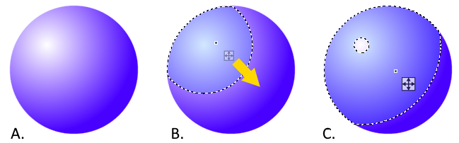

Dragging the click point
New to paint.net 4 is the ability to adjust the click point of the Magic Wand Tool while a selection is still active.
This replaces the need to undo and reapply a Magic Wand Tool selection if it did not cover the desired region.
The Control Nub looks like a white square with four arrows inside it (see image below).
Click and drag this icon to relocate the click point.
The selection will be reinterpreted as if the user had undone the original and reapplied it using the new source point.
In the image above, Image A is the original object.
Image B shows the initial selection based on the first click with the Magic Wand Tool. The click point is the tiny dark square near the sphere's bright spot.
The larger square with the four arrows is the Control Nub.
Image C shows the reinterpreted selection following relocation of the click point much closer to the center of the sphere.

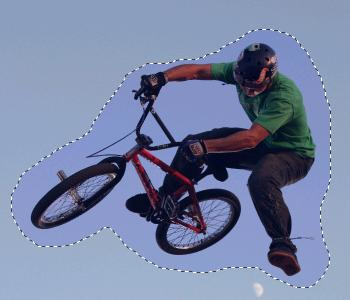

Example

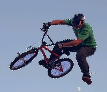

Lasso Tool used to make initial selection.
Using Magic Wand Tool in Subtractive mode to successively refine the selection.
