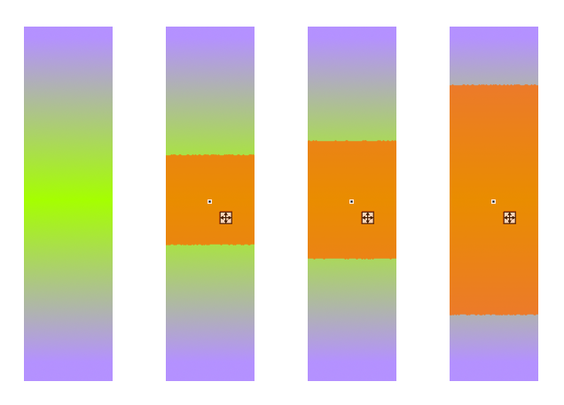

Paint Bucket Tolerance demonstration
Original image            Tolerance 36%            Tolerance 42%            Tolerance 60%
On the left is the original image. The second image show the original fill using a Tolerance setting of 36%.  The third image shows the fill covering a larger region because the Tolerance has been increased to 42%.  The image on the right shows the fill region has increased in size again because the Tolerance has again been increased. This time to 60%.

New to paint.net 4 is the ability to adjust the Tolerance while a fill is still 'active' and not 'finished'.  Altering the Tolerance reinterprets the fill operation using the original click point with the new parameter.

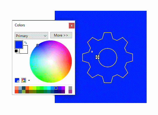

Change color on-the-fly
It's easy to change the color of a live fill, but this can only be done while the fill is still 'active' and not finished.
To change the color of a live fill, simply change the appropriate color in the Colors window.  If the fill has been made using the Primary color, select a new Primary color in the Colors window.  If the fill has been made using the Secondary color, change the Secondary color in the Colors window.
Changing the color of a live Fill
Tip
New to paint.net 4 is the ability to change the color of a fill while it is still 'active' and not 'finished'.  Altering the fill color in the Colors window immediately recolors the filled region.

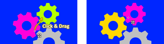

Dragging the click point
New to paint.net 4 is the ability to adjust the click point of the Paint Bucket Tool while a fill is still active.  This replaces the need to undo and reapply the fill operation to a different region.
The Control Nub looks like a white square with four arrows inside it (see image below).  Click and drag this icon to relocate the click point.  The fill operation will be reinterpreted as if the user had undone the original and reapplied it using the new source point.
Dragging the Paint Bucket click point
The image above shows an initial fill operation has colored the left gear pink.  It is easy to apply this fill to a different gear; simply drag the click point over the region to be filled.  The left hand image shows the relocated click point and the resultant changed fill. As the fill operation no longer applies to the left gear, it reverts to it's pre-filled color (yellow).

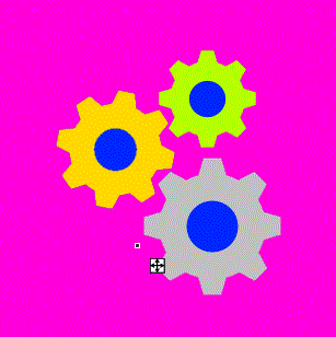

The action of dragging the click point is shown in the animation below.
Tip
New to paint.net is the ability to adjust the click point of the Paint Bucket Tool while the fill is still 'active' and not 'finished'.  Click and drag the Control nub to relocate the click point.  The fill operation will be reinterpreted as if the user had undone the original fill and reapplied it using the new source point.

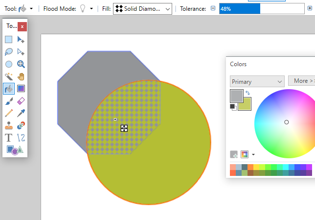

In the example shown below, two shapes were drawn.  The Paint Bucket was applied three times: once inside each shape, and once in the overlapping region.  The first fill used the Left Mouse button, resulting in a fill in the Primary color (gray).  The second fill used the Right Mouse button so the Secondary color was used (green).  The overlapping region was filled with one of the available Fill Styles (Solid Diamond) which uses both Primary and Secondary colors.
Example
Fill style demonstration
Example 1
Overlapping shapes before filling
Example 2
After two solid fills.
Example 2
After a third patterned fill.
