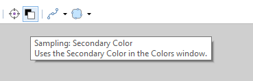

Sampling Modes
The Recolor Tool has two distinct sampling modes: Sampling Once and Sampling Secondary Color. These significantly alter how the tool acts.
Sampling Options
Sampling Modes
Sampling Once Recolor > Sampling Once
Sampling Once mode with the Left Mouse button recolors the color first clicked on with the Primary color.  Using the Right Mouse button recolors the color first clicked on with the Secondary color.
Sampling Secondary Color Recolor > Sampling Secondary
The Sampling Secondary Color mode is the same method of recoloring as seen in paint.net 3.5x.
Using Sampling Secondary Color mode with the Left Mouse button, the Primary color becomes the replacement color.  Pixels within tolerance of the Secondary color will be replaced.  Using the Right Mouse button reverses the roles of the colors compared to the Left Mouse button.

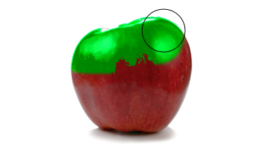

The Recolor Tool is often the fastest and easiest method to change an object's color. In the image below note how the recoloring action has respected the subtle variations in hue.
Example - Recoloring
Red Apple
Before Recoloring
  1. Activate the Recoloring Tool
  2. Set the Primary color to the shade you want to introduce (e.g. green)
  3. Set the Recoloring tool options in the Tool Bar (Brush width, Hardness & Tolerance).
  4. Set the Sampling mode to Sampling Once.
  5. Using the Left mouse button "paint" the new color over the old. Using Sampling Once, the first color you click on will become the color which gets replaced.
Partial Recolor
During Recoloring
