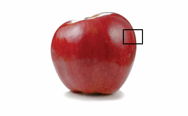

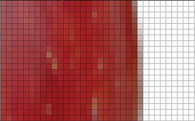

Pixel Grid
The
The same menu command can be used to toggle the grid off again. There is also an icon in the
Note
The Pixel Grid is not visible below 200% magnification.
These images show the pixel grid in action...
